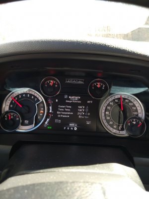

I hate seeing these temps. No anywhere close to what my 09 ran at. haah

Ok, yeah that's what he told me too...
I really need to do this along with a 180 t stat and remove the grille shutters.
qwAzXXWSwf2LL-LXfwtfajopsEAnC2SW1kVX_cwURKbgC4FSzddhNyqWTsnCD1wiiJTGcOM4a1nCrsmEPKgCW3u3zN4ngtSZ2mrSaa_-gy_iDj30n8kojb4twDQgdNOVxaa_qjAydsr5rAWr1qvm-gukHsy4ofdCOysXduJWx_ukLuaJgKa7RJtboa12nq28WC8H7yuqHrOqymAl7RQ2hpejzIixQnI-GXjAOaxmv0dLryIgEtJ76zFw3i-F01LnVDnVSQiSJAz8qQpKS0mht7z4G0JbcFdv2HoiyzjIQEhodYPAcZLj9Bbwnr2GNMao_vNLVcW_fO1tlEE5Ievi8dx8Fqu6eSm88NG4KgSIumVMSn1lfgz48wyEoDsplFz04apVlwOi8AutWHWQn3bQi0TUWR52OsF9OXVZmrMMVA4HFDeoRfvXAjneW41czgbCcB4fmVnIyrE2rL6wE5DWMmAtYXmrQtKdTXBVcSkIoozPi0icI_JOoH9brhWduAHYzD3srgSZcubUXF7GWLdxeaSSFrMO27R6sWw1V-B_YnLVI-ZjFue1lFXzS9-dYYeJkny--hRo8zEMOLKdnaGtPyd8Q6eKJfO4-UnKP99jWVMCz03mfQ27h5UHFyBeLm89H7Wt3eI4yS9NQcp44d_d-6DB4aY4hzWnjAxFpfsBKbvC_AItNam0ke-8e2zSg39QiDoiyB5olRtp-m5Nn4UUfYwS=w1204-h903-no
Trans it a bit high but the coolant and oil look good to me.
My truck still runs in the mid to low 190s coolant temp with the shutters completely removed and the 180 tstat

I wouldn't worry about the coolant and oil there, that's perfect. Besides, you won't have any control over keeping the coolant that low without a tune and electric fan. You'll be something like 220 before the clutch fan is fully engaged.
Losing the shutters will keep cruising temps down around 195 consistently as is.

Thanks for tips. I am going to try and do it this weekend.
I finally took it on the highway yesterday and those trans temps crept higher than the 185 it's been staying around.
Got a road trip next month, so I want to see how it does with the new thermostat installed.

With a 180 t-stat the coolant should stay right around 185 as long as the trucks moving ,even stopped in rush hour traffic if you still have the clutch fan in place it shouldn't run much over 190'ish.Even unlocked the clutch fan is still spinning and moving a fair bit of air and you'll have noticably cooler coolant temps then you would see with the stock 203 t-stat. Oil temps might not drop as much as you'd expect though,the crank bearings and valve springs are what generate heat in the oil,and neither are all that close to a water jacket to benefit from the lower coolant temps.Pulling the majority of the slats out of the shutters will help keep coolant temps in check,just leave 1 top and 1 bottom slat in on both sides and it won't throw any codes.
