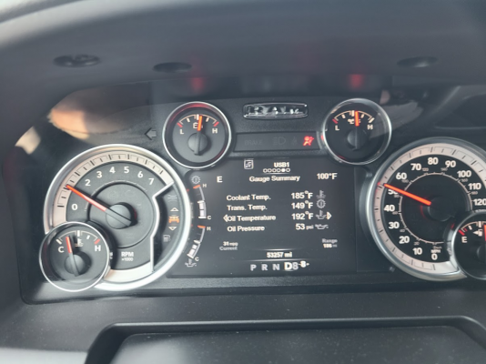

Ok, all is good after the install of @caulk04's THB(transmission heater bypass/thermostat delete)valve. Trans temp(s) are ~ 45° cooler with the average outside temperature 80°.
The before the install the transmission temps was ~ 179°-185°. After the install the temp(s) are ~ 129°-150°ish while driving highway and idling at stop lights, etc. That's much better.
However, the coolent and oil temps were up about 10° from where they normally were, coolent hovered around ~ 199°-203° and oil was ~ the same.
I resolved that by doing an partial AGS delete(removing all the shutters except for the top and bottom rows)and now these temps are back down to where they normally were.
All is good.
Interesting your coolant temp went up after the @caulk04 bypass install.
Mine went down both on the mechanical gauge on the dash and numerically down looking on the EVIC.
I have all my shutters still in place and the stock t-stat, and have done some heavy driving in very hot Ontario weather this season and my transmission still stays about 150 according to the EVIC. My oil hasn't gone over 220, and my coolant hasn't gone over 215.
I am however considering installing a 190 t-stat just to maintain some cooler temps. Regardless, my truck is quite happy and runs flawlessly at any time.
I couldn't be happier with my HEMI Ram :)

Other than my heat issue, I love my truck. I do feel that caulk04 by pass has worked (have had it installed for almost a couple of years now) because I have not experienced the 285* temps any more. Like I said it is not all the time. I have driven for 2 hours on hot days and the temps have stayed at 160*. But some times after stopping at a destination, I then start my return trip it will just start climbing, especially on the highway. I'll pull over and let it cool down for 15minutes it will go back to normal temps continuing on the highway at 75 to 80 mph. No rhyme or reason.

I've thought about installing the 180° t-stat, but the partial AGS delete helped to bring the coolent temp back down. I may still try that out ...
Yep, the transmission t-stat delete along with the partial AGS delete is an much better improvement on temps. All is good.

after deleting your transmission T-STAT, are you still able to monitor your transmission temps?
Yes you can still monitor transmission temps with or with out the transmission thermostat.There is no electrical connections to the TMU which is where the thermostat is located

I have gone and removed the AGS, all but the top and bottom. I did a short run around town for 30 min. But that's not really a test. The highest my trans temp got was 154* which has always been normal to me. The oil Temp got to 215* and coolant was around 205* off and on. I won't really know if this MOD is helping till I do a long distance run on the hi-way. It is about 88* here today while I was driving. While doing the AGS removal, I did not see any blockage around the radiator and AC cooler, other than a few little bugs and dust. Actually pretty clean for a 2016. I did notice and corrected on the left side of the AGS the flexible shroud/liner was folded over & slammed against 2 metal lines going towards the RAD area. I straightened it out as best as I could to resemble the right side. That was the only thing that looked wrong. I'll report back my temps once I go on a long trip.

I can honestly say after having the AGS delete done for over a month now, my truck consistently runs ~10* cooler, coolant temp wise. Trans is about the same, I haven’t installed my bypass yet

Yeah, I would say it is running cooler so far, but as far as testing the trans, I haven't done a long highway test yet
