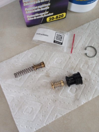

Hello everybody. Just an update on my failed attempt to swap the part.
I did receive caulk's modified piece - he shipped it very fast, communication was prompt.
I hit a snag on removing the plastic plug part of the thermostat. Got to it as per instructions removing driveshaft and park release break line, removed the snap ring, cleaned everything around it - no oxidation or deposits, see grove clearly. I could push it in and plug moved but never came out. Plenty of WD/40 spray, some silicone penetrating spray in desperation.
I tried running engine for about 30 minutes while on a ramp with break applied, driveshaft disconnected - even tried to switch to drive and rear while on emergency break and pushed brake pedal in hope that it would increase transmission internal oil pressure and push the plug out. Transmission warmed up to about 140 and stabilized while parked. Would not go higher.
Plastic plug did not pop and attempts to pull it out while tranny was hot lead to a sizable burn on my forearm from exhaust cross over - RAM engineers hate people... AFTER burning myself I put welder's jacket on - highly recommend it, lol! Plastic plug would not come out. That o-ring might be too swollen inside? Caulk was nice enough to answer my messages via text when i was fiddling with it!!!
There is no plastic nipple on my cap anymore after all of my attempts. I can't take a risk of breaking it. Installed snap ring back, parking level release bolts and driveshaft. back to square one.
I am camping next week - towing a decent size trailer, I will let you know what my trans temp will be without it installed. My truck runs at 195-205 with no load at highway speeds. I am a bit concerned.
it is 2016 with HEMI, well out of warranty, previous owner did tranny fluid change about 30K miles away, with RED fluid - not ZF/MOPAR one. I was planning to switch back to MOPAR fluid soon anyways.
P.S. Does anyone knows what size that snap ring is? I'd like to get a new one if I am to try attempt #2. Same for internal O-ring? I can get any size automotive Viton O-ring, just curious about size.

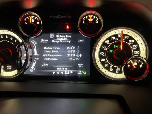

Well FINALLY got some time and decent weather to install @caulk04 bypass. With reading @crazykid1994 post back on 1/21 and @Daniel Ortiz post 11/22 in this thread thought it sounded reasonably and not to complicated to do. I would see trans temps run 174 to 190 in 40 to 50 degree outside weather just driving around town and didn’t like that at all. Grab some power tools and got it done. @Wild one suggested wrapping the crossover pipe with heat wrap so I did that as well while I was down there. Took about 90 minutes in total. Took my time to make sure everything was done correctly. Been driving with it in for 2 days and temps are way better now. I previously installed a stant 180 coolant thermostat and removed the middle shutters.
impressive...9k miles on a 19? I live 4 miles from work and I have 55k on my 16.

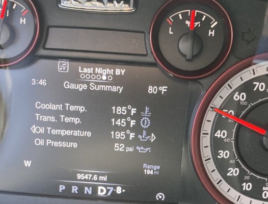

I just finished installing @caulk04's transmission heater bypass valve. All went well on the install and was easy.
However, after removing the snap ring and pulling out the transmission factory thermostat, I had a short blast of transmission fluid "shoot out" in my hair and eyes ... I wasn't prepared for that, lol.
I'll report back in a few days with the transmission temp difference(s).IMG_20230524_154328312.jpg
Same here. I know @caulk04 said its a couple ounces but tranny fluid laying in a puddle on the garage floor looked like a couple gallons. I thrashed on it good today and saw my temp reach 154 and then within half a mile or so right back down to 145.
