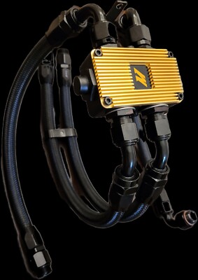

A new source for the Ram 1500 8HP thermal bypass for anyone considering it.
This is awesome Jessie...
Thanks for keep on making these. I tell every ram owner about them. Although I have to explain what it is and does because they are like WHAT??? lol

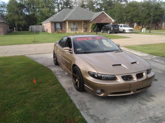

Yes it has the boosted 3.8,transmission is tired though,and it's not worth fixing the tranny.It's our winter beater,as it still starts at -30 unplugged,lol.I owned the car when it was a year old,then sold it for a few years,and bought it back a few years ago.The guy i sold it to,let his 2 boys use it ,so it was pretty well beat into the ground when i bought it back for $175.00 ,he was gonna donate it to the Kidney Foundation for the tax break,so i gave him what he'd of got for a tax break,put a good set of winter tires on it,and turned it into a winter beater.It still pulls pretty good on the highway,but you don't dare floor it in first gear as the sprag is hurt ,but once it's into 2nd your good to go
No **** huh???
Thats where I got my name from. I had a 98 Grand Prix GTP for about 20 years with lots done to it. Ported blower, rockers, ZZP intercooler, TOG headers, 2.8 pulley, lowered, sway bars etc!!! I loved that car. No lie about the trans. I went through three of them. It's the only thing bad about the car other then the rockers and rear towers rust bad in salt, the motor is a tank if taken care of.
It's now rotting away up in Michigan somewhere with a blown motor.:sad72::sad72::sad72::sad72::sad72:
Also had a 2001 Regal GS for about 5 years. I thought I would like it because it was the same as the GTP just slower. I should have kept since it still had super low miles but got bored of it. Wanted a V8. So sold it to get my last truck. The Orange RAM.

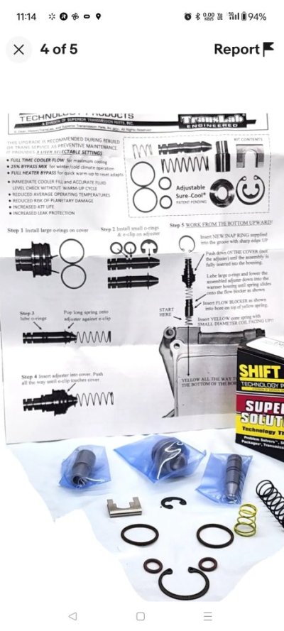

I plan to buy caulk04's mod. But have come across this which let's you choose noal. 25% and full by pass. Odd thing is the company no longer has it on their site. Scary thing i is I think the design may leak. What's the part number for the new black plug?1000007660.jpg

I plan to buy caulk04's mod. But have come across this which let's you choose noal. 25% and full by pass. Odd thing is the company no longer has it on their site. Scary thing i is I think the design may leak. What's the part number for the new black plug?View attachment 539455
Seems a bit complicated,especially compared to Jesse's kit. Don't quote me on this,but i don't think the black plug is a servicable item,i think you have to buy the whole thermal management unit to get a new one,so be careful removing it.Helps if you get under the truck and wash the hell out of the thermal management unit at your local coin-op carwash,before you work on installing Jesse's kit. Angled snap ring pliars make it easier to remove the snap ring,a touch of WD40 or something similiar sprayed on the edges of the plug helps when you pull it out.If your truck is a 4X4 remove the front driveshaft
