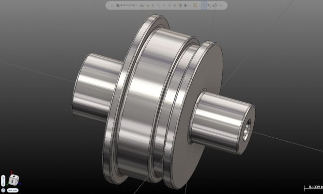

I plan to buy the bundle offer and junk the OE plastic cap.
The aluminum cap from Jesse's kit just makes more sense to me, especially given the price. :cool:
There are many testimonials from other members who have added this kit: I'm sold.
And, View attachment 582092 to Ram Forum.
Jessie has a aluminum cap now? That dirty dawg!!!!
That plastic cap it a pita to get off.
Well, if I ever get another Ram. I'm doing the bundle for sure.
You the man Jessie!!!

Yeah, it's been out there for a little while now. No more worrying about getting the plastic cap out without damage, plus I added a nice boss to the cap so you can grab it if ever needed.

Yessir. To date it fits all 8spd fitted to 1500 Rams, excluding the TRX
