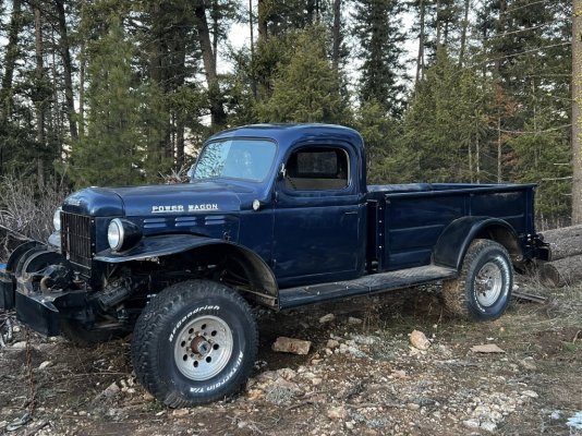

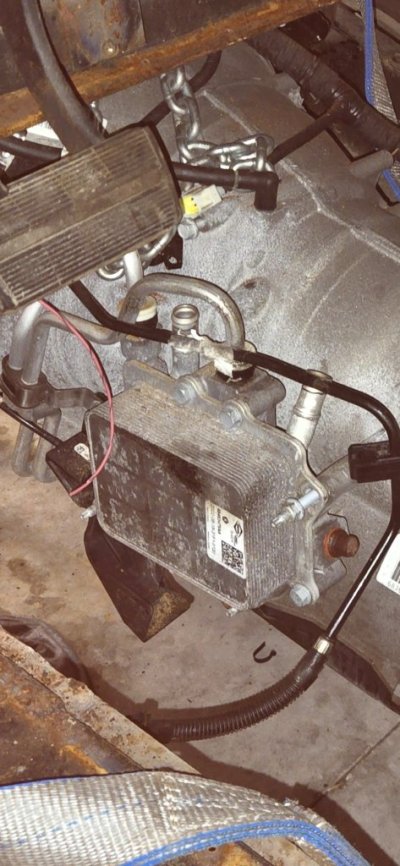

This is a GREAT thread! - I have an oddball request...I am building a 1955 Power Wagon- and installing a 5.7 w/ 8hp trans....and SPACE is extremely tight as these have very small Cabs. Hopefully - someone has the info I need. I want to eliminate this entire heat exchanger and somehow replum the trans fluid to a trans cooler. I need to eliminate this BIG hump I would have in the drivers floor. The existing trans fluid lines stick up too far into the 1955 PW floor.
You can delete it. I believe @Wild one on here has.
I forget the name of the guy,but if you google 8HP70 heater delete kits it should pop up,or ask on a few of the ZF swap pages on facebook,you should be able to track him down.He builds a aluminium block,that allows you to completely get rid of the thermal management unit off the side of the truck 8 speed,and lets you use a normal NPT fitting to plumb cooler lines for the transmission.I'd also run an inline Improved Racing either a 145 of 165 degree thermostat with it,so the transmission will get some heat into the fluid.Google ZF Swap pages on facebook,you'll find several pages dedicated just to swapping the 8 speed into oddball configurations.It's not uncommon for guys to grind all the tabs off the case to fit the transmission into tight tranny tunnels.

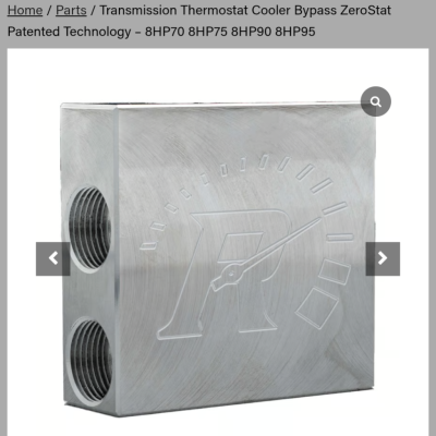

Hey all
My transmission temps are acting up and theres an associated whirring noise when the temperatures climb high. I've spent some time thinking about it and something that makes sense is a partially stuck or faulty thermostat. On some of my commutes (same highway, same weather) the trans will stay around 195, but on most other days it'll climb to 230. If the thermostat is in some way stuck or preventing flow, could it be causing fluid cavitation via partially restricted flow, resulting in a whirring noise?
Anyways, long story short, bypassing the trans heater seems like a decent first (cheap) step to figure out this problem.
My question: what's the functional difference between going with the Caulk kit versus doing the Revmax blocking plate thing?
For that matter, what does this do?

Hey all
Reach out to @caulk04 for guidance on next steps!!!

Hey all
The part you've pictured there looks like the thermostat bypasses available for RFE transmissions. They have a thermostat inline with the cooler lines and no separate heater.
My part will accomplish the same end goal as the revmax kit IF you install their kit fully. They give partial install options that don't make any sense. The benefit to my part is lower cost, easier install, and it's externally invisible which is helpful if you have a warranty in place and are worried about that.
I don't have any input on the whirring noise. There shouldn't be any fluid restriction even if it's stuck since it just transfers from one fluid circuit to another.
