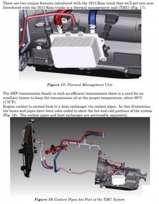

The thermostatic bypass valve on our Ram's is located within the transmission heater assembly. It unfortunately is not installed closer to the ATF cooler, like it is on cars equipped with the 8HP70 or 90. Were it in a similar position, I'd have bypassed it long ago.
There really are only two options, in my view, to lower the transmission temps on our 8HP70's. One, you can remove the TBV from the transmission heater. It is located on the lower left end of the heater assembly, facing the front of the vehicle. It is held in place by an internal snap ring. Remove the snap ring, grab the little protrusion on the black plastic cap and with pliers, ease it out. The TBV easily separates from the o-ringed black plastic cap, which then can be re-inserted and the snap ring re-attached.
Doing this will allow ATF to flow unrestricted from the cooler back into the transmission. The ATF will still mix with "heated" ATF from the heater assembly, but the overall temperature should be lower than with the TBV in place.
Only issue with doing this is access. On 4x4 Rams, the front driveshaft needs to be removed, and a rigid cable right above it, whose purpose is unknown to me at least, also needs to be partially detached/moved. Even doing the above, access to the snap ring is dicey; there isn't much room to maneuver.
You also could disconnect the engine coolant lines feeding the trans heater and connect them to each other, keeping that circuit intact, but those lines are on the very top of the transmission and difficult to access even if the vehicle were on a lift.
The other option would be to remove the trans heater assembly entirely. It then can be separated by removing 4 bolts, into two pieces; the heater, and a cast aluminum manifold that houses the TBV and also has the attachment points for the lines to the trans cooler. Remove the TBV from it's bore as described above, and drill/tap the two ~3/8" ports that move ATF into and out of the heater, for 1/8 NPT pipe plugs. Then re-attach the modified manifold to the transmission and re-connect the cooler lines, and connect the two engine coolant lines to each other.

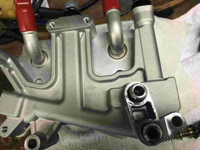

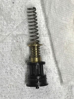

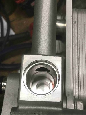

Here are a few pics of the TBV, it's bore in the cast aluminum manifold, the back of the assembly facing the transmission itself, and a diagram showing the fluid flow.

When I still was running the OEM T-stat (203 degrees), my trans temperatures were 185 - 188 while cruising on the highway. After installing a 180 degree T-stat, the trans temps are exactly the same. After an aggressive pass, I've seen trans temps spike to over 195, and then take a long time to drop back to the 188-185 range thanks to the TBV, because even when open, it doesn't allow full flow of cooled ATF.
The TBV is the little device that keeps the trans temps artificially hot. It does not allow any ATF, after being cooled in the trans cooler, to return to the transmission, until the ATF is at least 180 degrees. Once at that temp, the TBV opens a little, letting some cooled ATF mingle with the hotter fluid. A few times I've seen trans temps drop to 179 for a second or two, then it jumps right back to 185+ when the TBV closes. The engine thermostat really has no effect on transmission temperatures once everything is warmed up.
Bottom line is the TBV is a thermal management device that Mopar uses to make the 8-speed run at temperatures which yield slightly better fuel economy, in my view, at the expense of some transmission life. How much of a fuel economy improvement is unknown compared to a transmission running at say 160 degrees.
Mopar, or any OEM for that matter, is really only concerned about component life for the duration of the standard warranty period. After that, it's not their problem. I'll also bet that the # of buyers who opt for the extended warranty is statistically small compared to the entire buyer population, and any "failures" in the extended period are regarded as a financially manageable risk. The transmission thermal management devices are a fuel economy ploy to improve their CAFE, however small, because improvements = $$, thanks to putative regulations from our government.
For those who never plan on keeping their trucks past 100K miles, or trade after several years, it's not an issue. For those who tend to use a vehicle up, it's something that bears addressing in my view.
