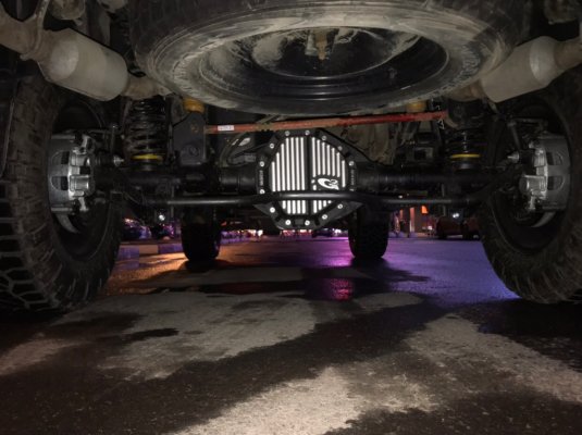

As far as I swapped gears to 4.56 in the past, I was searching for the rear axle with 4.56 gears. The best one that matches my application is AAM 10.5 full floating HD axle with e-locker that was installed on 2009-2013 RAM 2500 Power Wagon. It wasn't easy to get a new axle as it was already discontinued since last year. But I got it!(God bless Arizona:))

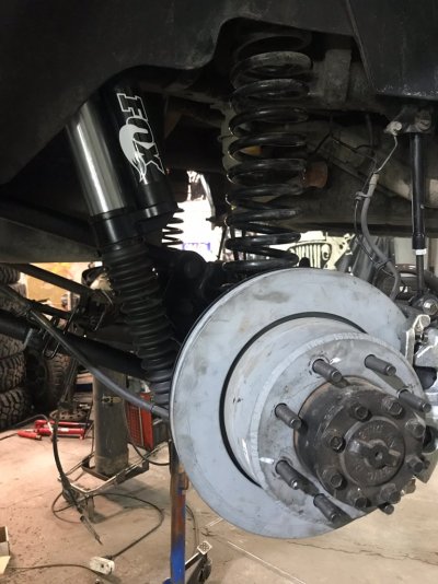

There wasn't an issue to weld 1500 axle brackets to HD axle
The biggest problem is ABS - as AAM10.5 has only one speed sensor above the gear, so ABS tone rings needed (made by Yukon) that fits 2014 RAM 1500. Those need to be put on the hub and adjusted well.
Drill a hole for the sensor
Then a bracket for the sensor need to be welded to keep it in place.

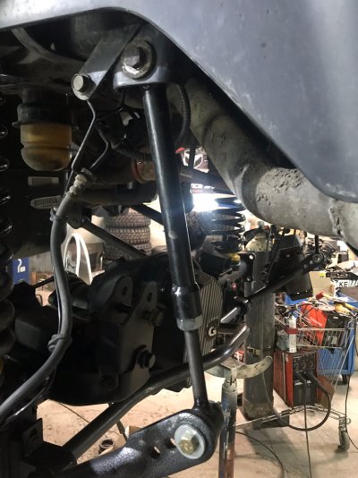

I've decided to install new shocks 2.5 FOX with reservoirs to improve handling of rear axle that is significally heavier.
Oh, I had a rear sway bar made by Hellwig for the 2500(bought in the past by mistake), that fits HD axle perfectly!
The last thing need to be done is a driveshaft. Hopefully it will be ready tomorrow, so will ran a first test...

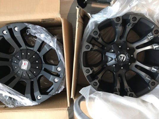

Yes, the front remains with 5 bolt hub. I bought the same wheels(brand, design and offset) but 8 8x65 bolt pattern. So having 2 Fuel Vapor and 2 KMC XD wheels now without any chance to
sell those:))

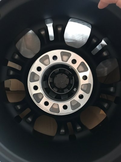

Sure! I have winter and Summer sets:)
So 2 of each design
For 8 lugs hub
So the rear hubs looks like this
QwikKota
Apr 2, 2015
1,528
1,112
5.7L
Ah, that makes more sense now. 2 complete sets.

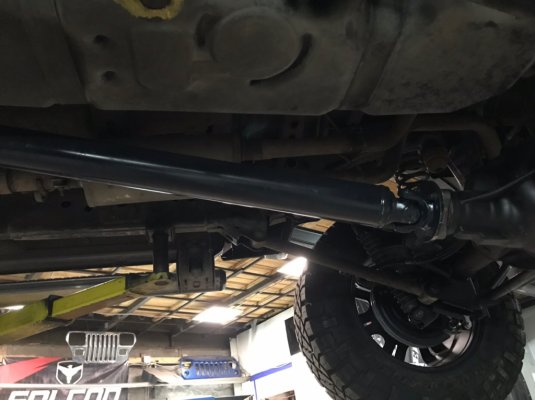

Finally, custom driveshaft arrived and installed
Everything runs smoothly, waiting for 500-600 miles to oil change and after will start a real test:))
