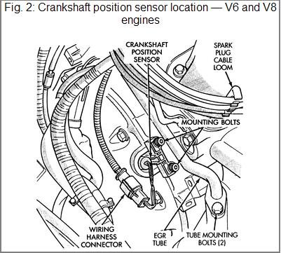

sounds like the crank position sensor has gone bad. it should be on the passenger side of the bell housing.

Crazzywolfie, my son is saying he can't find the sensor. He is about 165 miles from me or I would run right there and try and locate it for him. Are the wires going to it visible?

wires might be visible. i am not really sure since i have never had to replace one. it should be on the bell housing above the passenger side exhaust manifold. it might be a real pain in the ass to get at but if you have replace all the other sensors that is bout the only one that is very important and easily overlooked
