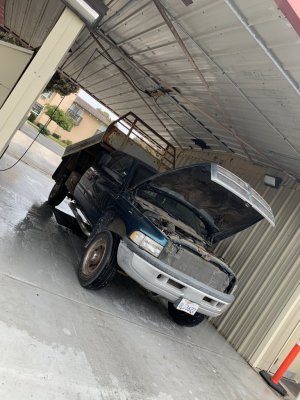

So far I took it over to a heated pressure washer and cleaned it up. I put degreaser into a pump sprayer and sprayed it down, and spend an hour boiling the truck clean. Pretty satisfying.
I see it needs a tie-rods and such. I remember putting a moog kit on the truck in my profile pic. I also vaguely remember something about using 3rd gen parts that are supposed to be more robust.
It looks like the axle seals have been done a few times. On my 1st gen the inner part that the seal rides on was worn. On one side I set the seal slightly out and it held. On the other I had to do this sleeve kit to get it to seal. Wondering how it will look in there.
I also see the lower control arm bushing are shot.
All points to dropping the axle down and replacing shocks, bushings, etc.
So I think I will do the interior and front end. Then have a buddy sandblast the bed and frame, undercoat and bed line, do the body work and paint.

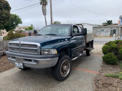

Here are some pics so far.
