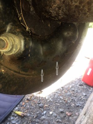

Yer gonna laugh hard on this one, but: When you say "pop the plastic cover off the oval hole" do you mean one of these bad boys in the picture?

Yep. Looks like they used the same part for the left vs right side backing plate, which is why there’s two holes. One will have the adjuster wheel behind it.
Looking at the pic those may have never been used. Looks like they’re stamped out but maybe the steel blank is still in place.
Usually that’s a complete hole with a plastic plug inserted.

There are no adjuster holes on these trucks . They have to punched out or ground off.
