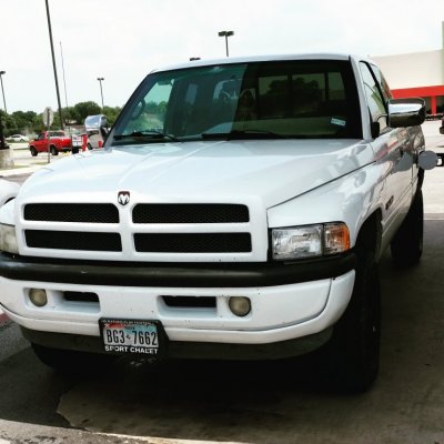

Ah! Gotcha man thank you! Would a 2.5 inch skyjacker lift be good? This is Maddy. She got a new paint job :)

Ah! Gotcha ! Thank you! How do you get the wheels to stick out to the sides?

Offset on the rims or wheel spacers but Id recommend against wheel spacers...too much load on the wheels sticking out and who knows when the spacer will break and off goes your wheel.

Offset on the rims or wheel spacers but I Dwight recommend against wheel spacers...too much load on the wheels sticking out and who knows when the spacer will break and off goes your wheel.
Lots of mixed feelings on wheel spacers. If you decide to get them make sure you get the ones that bolt on, not the ones that just sit in place.

Don't do wheel spacers everytime i see somebody with them i think how can they even be happy with the way that looks? Don't pretend to have an offroad machine if you want wider axles then get wider axles don't pretend to have them, im happier with my stock looking rust bucket than i would be with wheel spacers.

True, I'm just excited for my lift and I have to wait like about 2 weeks to buy them. That's why I ask, I don't mind taking them off again.
