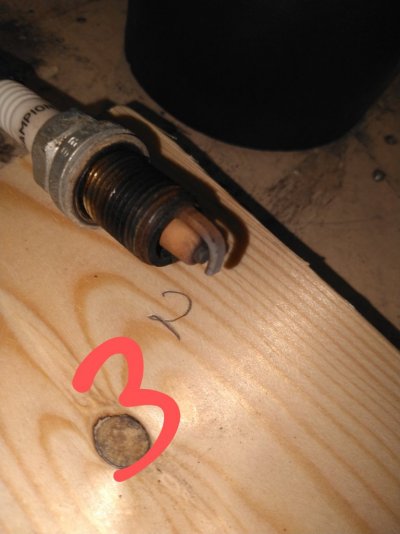

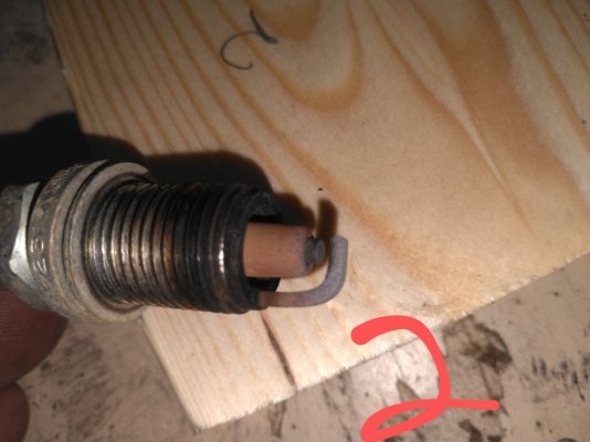

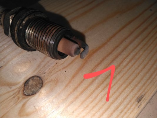

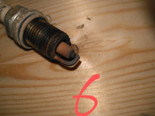

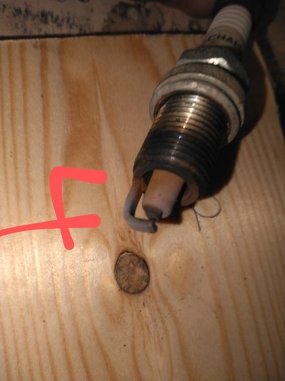

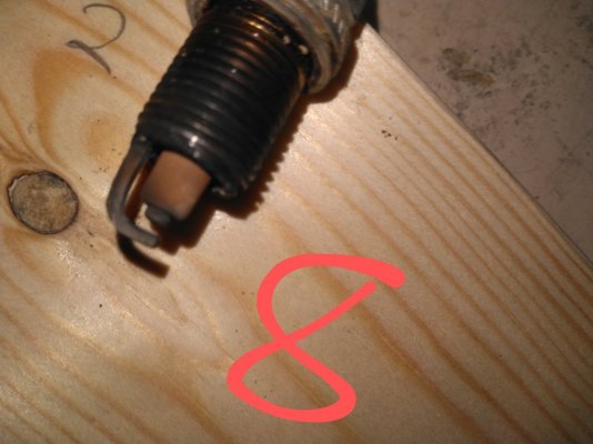

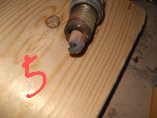

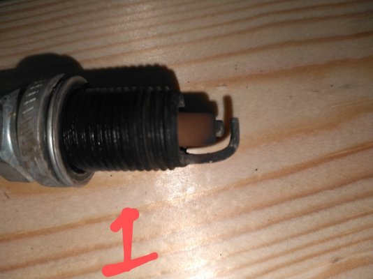

Part of my silence has been from the tapatalk app no longer working. That just made it easier to get notifications on my phone. Today's update. I have yet to discover the torque leak at slow speeds. I just ran a compression test, all cylinders were between 170 and 175 psi.

All the plugs had the correct gap. Truck almost acts like the converter has no stall at low speeds. I can feel the converter lock at the proper times. I was able to adjust the tv cable so that the truck is more driveable. The tv adjustment wasn't off, I'm just making it kick down sooner, and hold the gears longer until the truck spools that non-existant turbine:rotflmao:

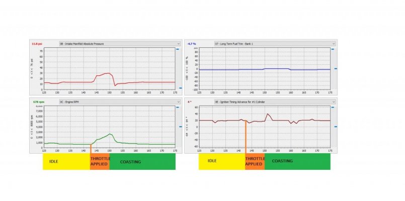

So I was data logging and noticed that the pcm is pulling the timing wayyy back. I know the tune didn't remove all of the torque managment, but it never was that low before all of this. No I just need to find out why it's pulling out all of my timing. It doesn't even let the timing ramp up.

Another update. I shot an email to the company I purchased my tune from. I asked if they could say why the pcm might cut timing. I also asked if there was a way to datalog. Using the supplied tuner since it comes with a usb cable and the tuner says datalog. Imagine my surprise, when the answer I got was take it to the dealer, we are not a service center. Wow, I shall never use them again. From now on, I will just go local, no matter how long I have to wait.
