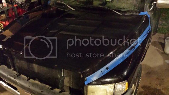

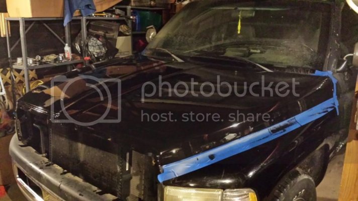

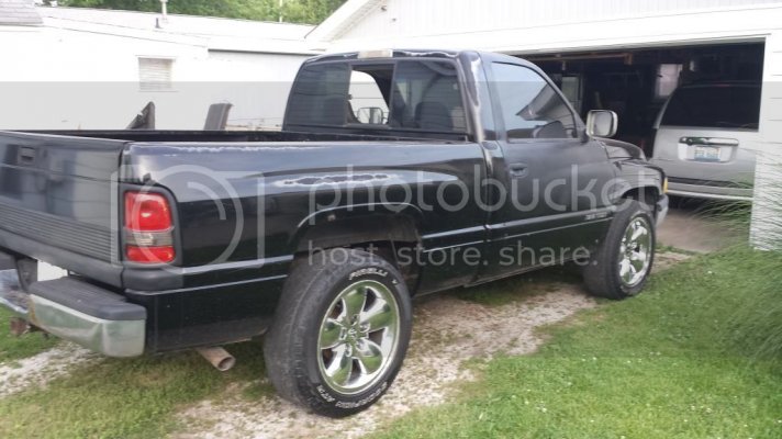

Here is my 99 shortbed shortcab Ram. Picked it up on the cheap. I'm just fixing a few things and giving her a panel by panel repaint, fixing the power doors that the PO cut all the wires on and in time replacing the busted to crap dash and a few other little things. Final goal is a stock brand new looking truck with a 2" front leveling kit and a good set of A/T tires. Maybe a small stereo and tinted windows. Enough of me jabberin, on to the pics. This is the first 2 days progress.
Dents from the hood flying up fixed
Hood all sanded and ready for paint.
First coat of black.
For those interested. Paint is Rustoleum Industrial enamel applied with a foam roller. I do know body work and paint, but ive done 2 other vehicles this way and it works great if done properly and is a great cheap alternative to maaco or rattle cans.

Also, got any pictures of that hood in daylight? That looks REALLY nice.

Looks good so far man. And yeah post up some pics of the hood in daylight.

I will, as soon as i fix it. I screwed up and didnt change rollers between coats and using an oil based paint like rustoleum, the roller disintegrates in about an hour. So when i did the second coat it left chunks of foam all in it and was really runny. I can clean it up and post a pic though. Ive painted 3 vehicles with a roller and one was a black S10 that won a few cruise ins and shows. Its all in the prep work. Still waiting to get my compressor fixed to D/A the hood all back down and re-do it.
