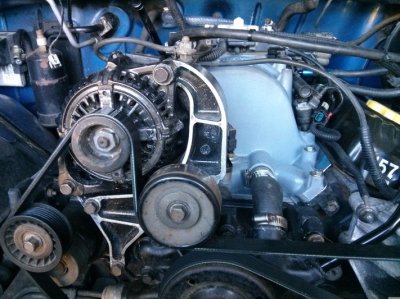

So heres how I got rid of the AC, I took the braket to work and cut the chunk off that the compressor sits on. Got a 92" belt and its done. This truck is almost ready to run again. Its been a big job, but worth it I hope.
