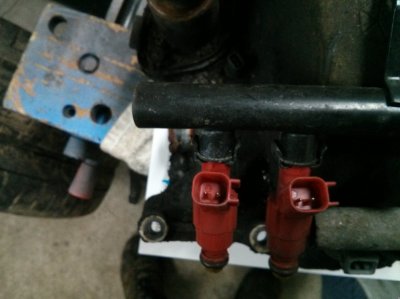

So heres the 96 old grey ones, and the red ones on the 97, see the diff. Also see the 2 coolant sensors on the 96. The 97 only had 1.

The build date on the 97 was 6/97. why would it have 00 or 01 injectors. Cause the plugs are obviously different.
dapepper9
Feb 7, 2013
5,906
2,227
Iowa/Nebraska Border
2001
5.9L V8
Check the sides of the block for casting numbers. Likely a cab swap, somebody may have swapped injectors and spliced new connectors in or something along those lines

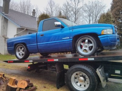

Ya thanks, that's what I wanted to know. It will make putting this harness in a lot easier with out all that stuff in the way. Plus then I can clean things up to get this thing looking half decent again. This is what I picked up.
dapepper9
Feb 7, 2013
5,906
2,227
2001
5.9L V8
The non-ac equipped trucks used a different alt bracket though. Factory replacement no ac belt will not work for you. Dudeman posted a good pn
