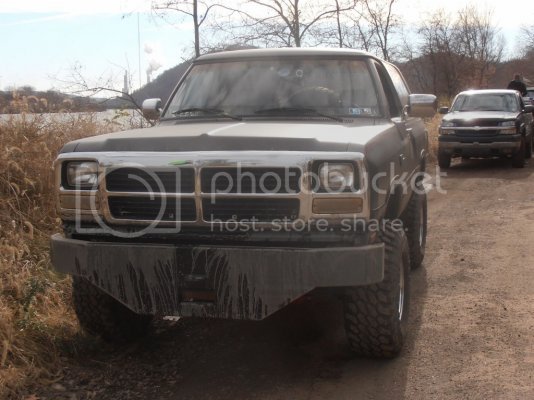

So Nick, who's tube buggy has no plate, had driven that off the trailer, and driven back up to the entrance to greet me, when the officer hassled him. So I drove him back to where his truck and trailer were, so he could get them, come back and load the buggy, and get outta there. Have some nice video of the RC bouncing through mud to get back there, but I can't get it posted yet. Here's a pic of the RC BACK at the entrance by his buggy, waiting for him to return.

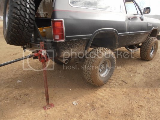

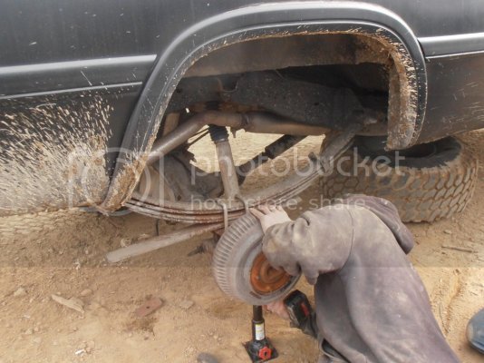

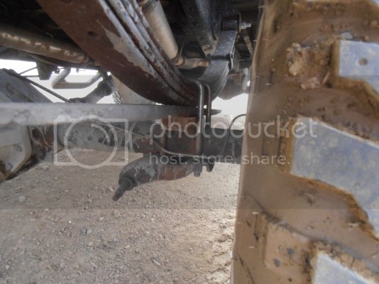

And so we get to where we can finally start doing some TRAIL running AND... the eyebolt in my right rear spring pack is broke...

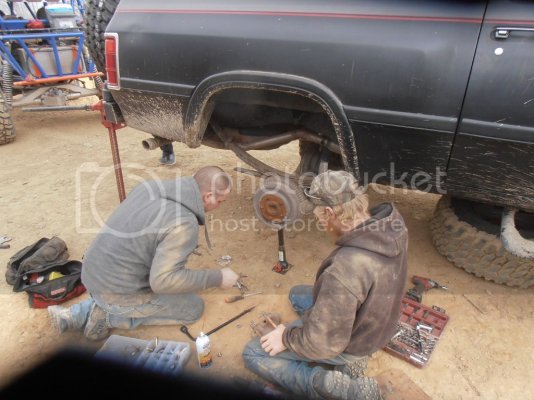

Nick tells me up there, that the rear end was "crabbing" the whole way up (and honestly, I've felt like - for a couple of months, my rear end HAS been trying to pass me on the right!). So Nick and HIS buddy Zach (no relation to MY son, Zach!), bust out the tools, the hi-lift, and we go to town - on TOP, of the forbidden zone!!!
Wedgie is popped out of the spring pack!
Time to pop the pack apart, go through our boxes of bolts, and see what we have to replace it. Cordless impact wrench make light work, that's for sure!!! Glad Nick KNOWS what he's doing when he goes off-road!
Nuts and washers Nick had - LONG enough bolt, we didn't. So thinking outside the box, Nick pulled the bolt out of the spring packs front retainer clip, secured that with some wire (the rear clip and the "new" eye bolt together would be enough to keep the spring pack from going '52-pickup'/SCHPROING on me). They cinched everything back down tight, and while the shim wasn't popping out (yet) on the left yet, the U-Bolts were loose enough to tighten with the impact gun as well. We figure the eyebolt is probably bad there as well, but that'll be a fixer-upper for a future cold day this winter.
