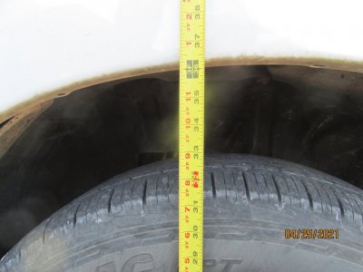

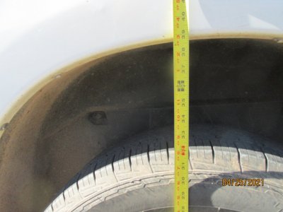

Finally, does anyone know the stock height front and back for the 2wd RCSB? Can't find it and people have asked how low I went, can't tell them, lol. Supposedly the kit was 3/5.

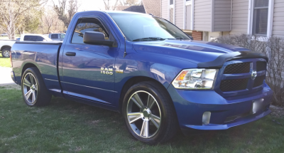

My RCSB is on a 2/4 drop with 285/45/R22 tires mounted on 22 x 9.5 wheels and I do not have any rubbing issues. Stock 275/60R20's are 33" tall and the 285/45/R22's are an inch shorter in height. Rear bump stop cups need to be removed.

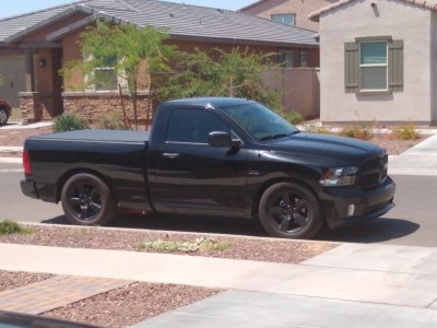

The picture in my signature is stock height... hope to have the drop installed next month

I'm still looking to know the stock height from the top of the wheel well (front & back), if anyone knows.

Any pics on the 22s? Sounds like what I need.

Love the truck!
Although mine's a different year and suspension set-up, I had the exact same issue up front when I lowered mine and hit dips in the road, 22" here also.
I put on performance shocks and it completely fixed my intermittent rubbing in dips on the front.
