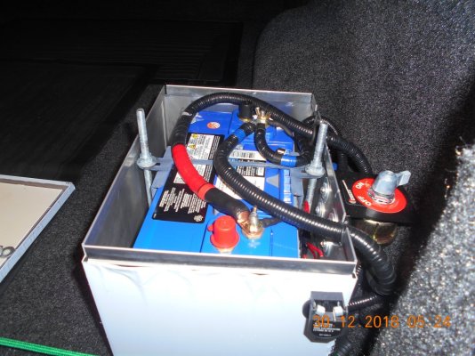

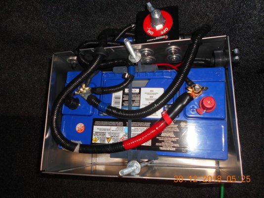

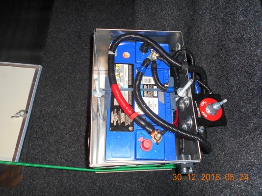

I had a big ole Group 27 AGM in my trucks relocated battery box,and the trucks charging system never had any issues with keeping it fully charged.

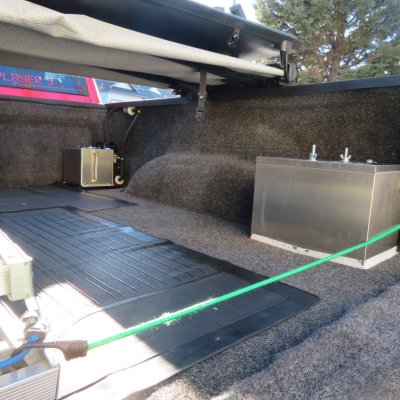

Oooh look at you Mr big fancy pants and your shiny battery box ;) haha
Once i finally got around to peeling the shipping protector off it,it even looked shiny on the outside,lol.
