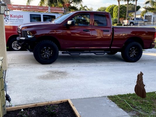

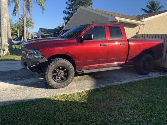

You should have upper control arms if you are 2” or higher. It’s better for the upper ball joint. I went from a 2” level with bilstein 5100 to 3” with eibach back down to 2.5”. Rear is lifted 1” with eibach. At 2” the 33s looked perfect. Went to 3” and the 33s started looking a tad small for me so went to 35s. Back to 2.5 and the 35s still look good. I went back down to 2.5 because I like the look better with a bit more rake. My truck was fairly close to even at 3” front 1” rear. First picture is 3” and 35s. Second is now at 2.5” and 35s. Next set of tires I’ll be switching to a 285/75r18 which is a pinch smaller.
Edit: actually looking at that first picture may have been when I was at 1.5” rear… my trucks been all over the place with heights. Lol.
