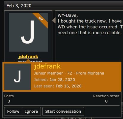

The OP hasn't been here in over 6 years.
It would be best to create your own thread.
