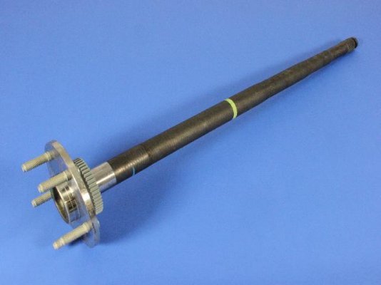

What does the rear abs sensor off a tone ring or wheel bearing
not sure what exactly you are asking here?
On my 2012 though, there are two tone rings, one on each wheel. They are on the axle shaft, just behind the flange.

That's was exactly what I was asking so they do have tone rings thanks I'm hoping to get look at it in day or two
