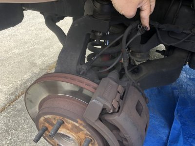

I believe that my truck is real wheel ABS only based on the number of hard lines coming out of the ABS modulator. However my left front corner has an ABS sensor tethered to the brake line, not installed. Trying to figure that one out.
Thoughts?
BOOMGUY
May 22, 2019
9
Tacoma, WA
I just pulled up a build sheet online and confirmed that mine is rear wheel, two wheel, ABS only.
