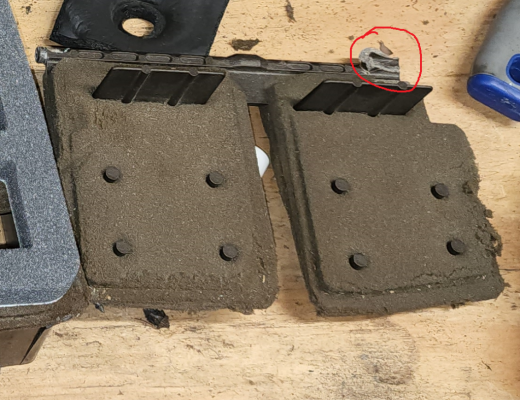

Just rebuilt a HVAC box a couple weeks ago. The "door" issue is pretty well known. The actuator input pivot fails on the door (see attached picture). The one that I rebuilt, the recirculation door would not open or close either, however that was the only door that was not broken. The actuator motor had failed. This one also had the resistor failure. (see attached picture) It is worth noting, while the blower motor is "working" it would be wise to have a tech perform and amp draw test. The one that I rebuilt the "squirrel cage" would turn yet squeaked as it did. i.e. the reason the resistor failed. A binding on the motor will induce a higher then normal amperage draw.
