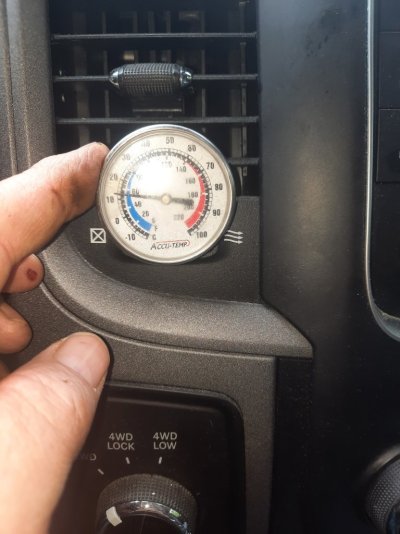

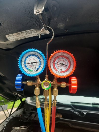

HI ALL me again LOL still having issue here is another update new blower fan (evap coil no dirt used a scope), drain port cleaned, cabin filter replaced (old one looked like new one), put some gauges on looks a little low to me (see pictures). talked a an AC installer he mentioned moisture in system and would need an evac and a vacuum down to boil water off.

Most likely no water in system since it still has some freon. You probably have a slow leak based on low pressure.

Can't read the low side gauge well but looks like around 20psi, and on R1234YF that would be an 18 deg f suction which is too cold for an AC application and will cause the evap to freeze up. you are either low on gas of have a restriction on the metering devise. if you have a vacuum pump available, recover the gas and pull a good vacuum and recharge with the specified amount of refrigerant. Your suction temp should be above freezing level.

Yup, you are low on gas. Check all the fittings and such with detector. Not unknown for an o-ring or fitting to leak. Schraeder valve may be leaking, also.
May need to add gas to get pressure up so leaks are more prone to show up.

I added some Red Tek 1234yf now have low side up to 30-42psi I'm going to run for a few week and if issues still there I can loan a reclaimer and vacuum pump and try that root
