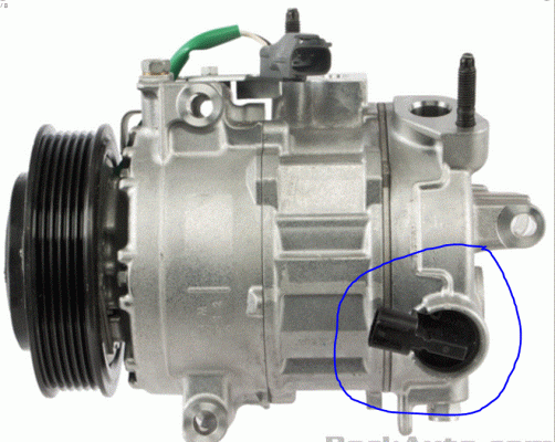

So, on to the next step in troubleshooting. But I'm not sure where the pressure switch is. Did they move it into the compressor? I see 2 pigtails coming out of the compressor but I don't know what each one is for. Is there a FSM that I can download anywhere with the wire schematics and all the different sensor locations?

Should be a pressure transducer on the high side line. Perhaps 68308727AA?
Is that on the high side at the compressor? I was curious why the compressor had 2 pigtails on it. I'm not used to that.

Away from the compressor there is a transducer/pressure switch on the high side line. The upper connector should be for the clutch and the lower rear connector should be for a pressure transducer or solenoid.

So there's 2 pressure transducers? I'm trying to figure out what the plug circled in blue is for and whether it should be a switch or a transducer that sends an analog signal. I don't hear the clutch clicking at all over the sound of the engine idling. It's definitely not spinning though, and pressures never fluctuate between high side and low side. Is there a set range the pressure transducers need to be in between or would it be possible to trick the computer into turning on the AC Clutch with short(12v+) and open(0v)
my 2020 shows a large fat harness connected there

That bottom lower one is what I'm talking about as well. It may be a solenoid that closes if it sense pressure loss. My home a/c has that to save the freon from leaking out. I would think you would need to close the circuit on the clutch as well as open that solenoid but the latter may be riskier.
