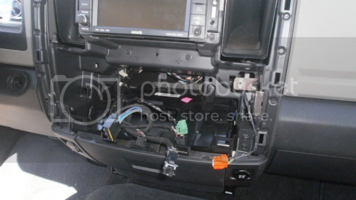

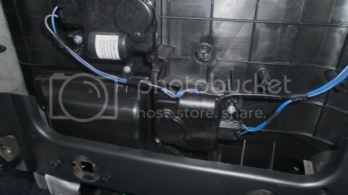

This is the blend door motor in the center.
