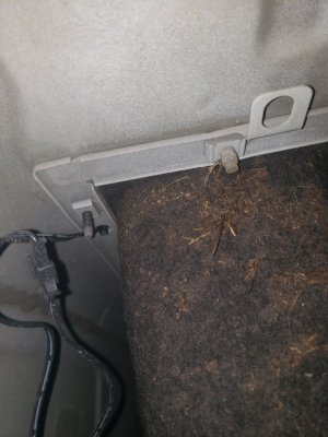

Hooked up some new accessory lights under my truck. I went through my rear footwell storage, under the carpet, along the door jamb, and back to the back seat where I tapped into the back seat light harness. Even if you don't have the lights under your backseat (I don't), you probably have the harness (I do). Cool thing is, these will now turn on when my dome light is on (when I unlock my truck). Double sided tape, very easy to mount. Top pic is my driver side with my first set installed. Bottom pic is my passenger side where I haven't mounted any yet.

Where exactly are they mounted and how many per side.
I’d love to do this
The set comes with 2 strips of 4. The lit up picture is just 1 set of the 4, I hadn't mounted the passenger side yet. As to where, if you look at the picture of the mounted light, you will see a "lip" towards the bottom of the picture, that is the lip to the outside of my truck. I'm not sure how to describe it other than, as soon as you get under your truck, look up at and you'll see a nice flat surface - that's where I mounted it.
