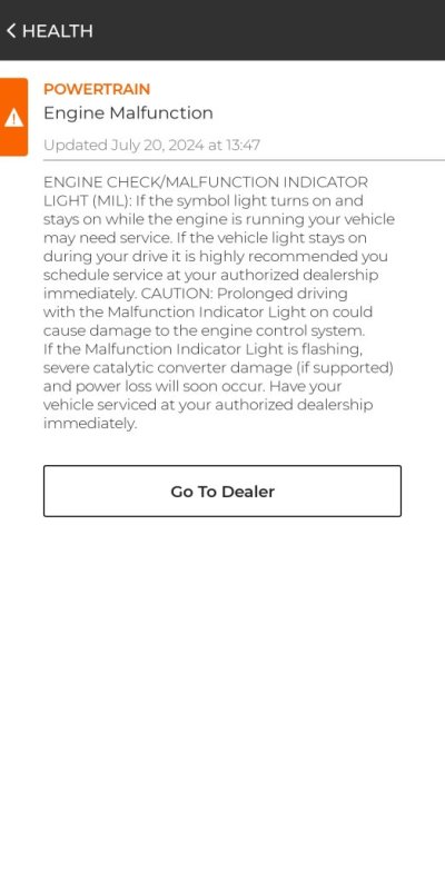

Hate to bring it up again on here. I removed the aad. No lights on the dash yet. Not sure if anything will show up on the uconnect screen. I removed it a couple days ago. Just now got a notification from the app on my phone.
I've seen folks saying mount just motor back on. Which I plan on trying first. If I do that is this notification gonna go away or does the dealer have to look at it an reset it through uconnect?
Also I figured I'd try to do the obdlink mx+ to turn it off? I read someone say they tried that an still got the notification in the app. I want To avoid hooking anything to the obd2 stuff that could void a warranty. If that's even likely. Can't imagine how turning off an air dam could void a warranty on anything but that specific part. If plugging just the motor back up will reset the code, without a trip to the dealer I'll do that for now. Truck is practically brand new with less then 7k on it.
I also don't see why these dealers can't turn stuff like that off. They say they can't but I mean the rebels don't have them. So there has to be a setting in the program to turn it off right?
Any explanations, advice, or experience is greatly appreciated. T hank you anyone!Screenshot_20240722_021318_Ram.jpg

On my 23 Laramie the only error I got was in the app there were no codes when I initially unplugged the AAD.
I turned it off with Alfobd and the AAD error still appeared in the app.
To remedy this I took the AAD apart and only reinstalled the AAD motor.
