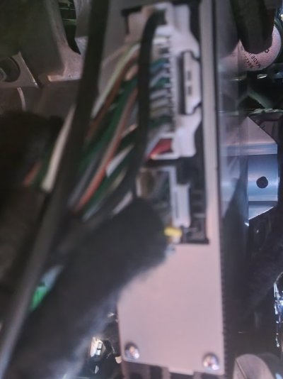

Looks like it will my first purchase! Reading on it and sounds interesting. With my truck , I think I found the place it would plug in. The picture below is under my kick plate from the driver's side
SitKneelBend
Moderator
Member Relations Specialist
Jan 8, 2015
10,952
7,629
St. Louis
3.6 Pentastar
If you're referring to AlfaOBD, it gets plugged into the OBDII port under your steering wheel using either a Bluetooth or wifi adapter.
