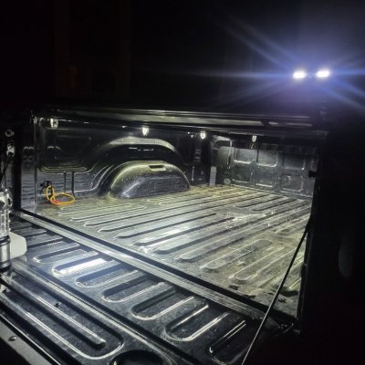

Wired them to come on with cargo lights on 3rd brakelight, with help from Boosted Motorsports youtube video. Finally converted all my halogen lights to led with a lot of trial and error, waiting on 3rd brakelight to change the one I have that has water in it

Looks nice. Also just a suggestion, if you add a LED behind the red lens of the CHMSL, the LED color should be red as well.

Sorry about that, I thought you were just going to replace a bulb in the stock unit. You will have to let us know how the new one works out for you since many have had water leaks with the stock ones.

love the bed lights
i wired mine to a hot from the trailer plug, and installed a N/O switch in the tailgate
when i drop the tail gate, the lights come on
why this is not a basic feature is beyond me

The after market cab light did leak, I've since replaced it with another, it's been in 2rain storms and so far hasn't leaked
