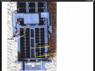

I have a 2018 PW and was going to add a front camera. I do not have a factory cargo camera so I was going to add it there. My understanding is that I would need to connect the camera to pins 24 & 25 on the radio connector. Problem is there are already wires connected to those pins. Is it possible that the factory cargo camera harness is connected to the radio even though I didn’t get the cargo camera option? Or do the 2018s have a different pin layout on the radio connector?
It just means that the cargo cam wires are at least present up the the next connector in-line. E4fNiIN.jpg

I removed the two wires connected to pins 24 & 25 connected the new camera connector there and it worked.
