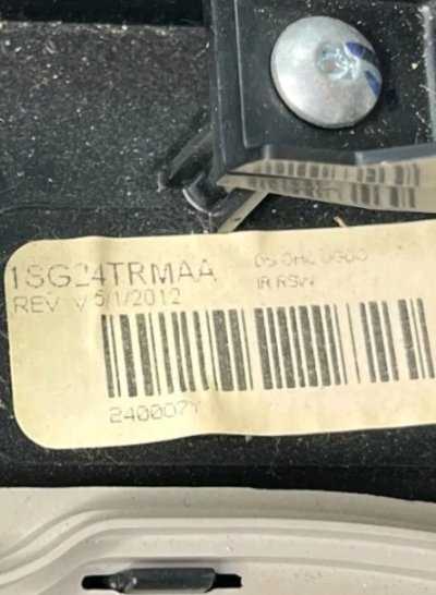

not sure to be honest...bought it off ebay, it said 09-12 models
Ok 2013+ are not compatible which is why I asked. Do you have the part number from the back? Can you take a picture and post it here?

I believe this is the correct number...I have already installed the part and reassembled everything...I have another pic of another sticker, but it appears to just have the patent numbers on that one
