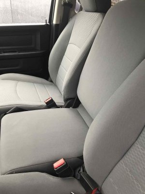

I have done the center console swap going from jumpseat to center and it is straight forward. The radio bezel will need to be switched with shorter version and of course you will have to find the jumpseat with the correct material. Do you currently have rear air?

Some do from what I have heard. Some I believe they go under the carpet in a tunnel of some sort and some are above the carpet. I have many of the radio bezel parts and the lower cubby parts in black as well as a jumpseat although I am sure the grey fabric from my express does not match. Not sure if they make a covering. Many in here no better of the routing of the rear duct work.

Pictures for reference only
