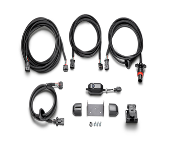

This is a 7 pin connector trailer electrical hook up, it is for lights & brakes
I believe on the opposite side
there would be a cable fitting similar to what is on the backside of your tv
Authentic Mopar Trailer Camera​
Part Number: 82215770AB​
