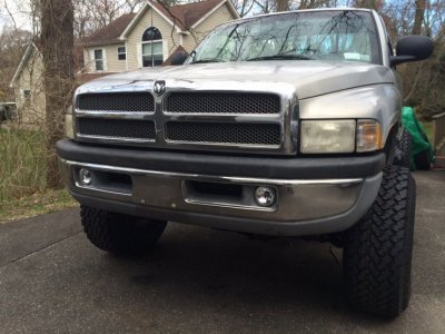

Got the lights installed finally. Was very easy to do while the bumper was off for the body lift install.

Couldn't find it. I bought a factory switch, figured out the pin configuration, wired up a relay myself.
