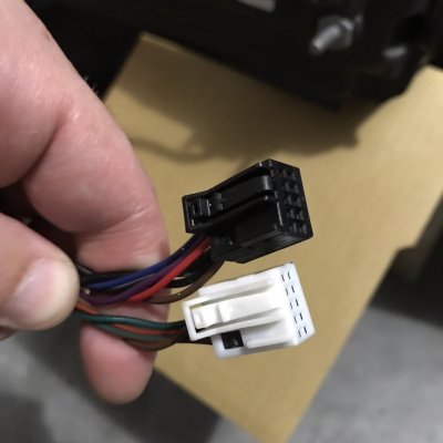

I will get photos of the connectors. The mirrors I bought are LED turn signal & puddle lamp, non-power folding.
Here’s a photo of the sticker on the new mirror, and the plugs. I’ll post a photo of the OEM plug & door module in my truck in a little bit. 8f0ed5c54c417878a577d9ce2f54bef1.jpg5b6f5596e19ed1533332e2536bec636c.jpg

Yep, those are non power folding. I would try another dealer honestly. They aren't tow mirrors are they? Forgot to mention that in my previous post. If they are you will also need the support brackets for them.

Then you should not have to change anything other than install both plugs on both sides if it is similar to mine. You should only need to change the door modules/switch when you add the power folding. Once the codes are activated they will work. An honest shop should only charge you for and hour or less shop labor rate.

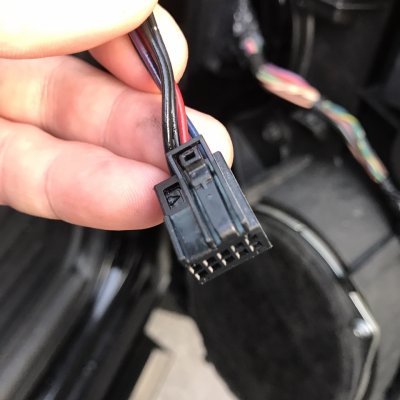

Here’s the stock mirror plug and the door module with the stock mirror plugged in if you need to see them.
There’s another dealership not too far from me, I’m going to give them a try.

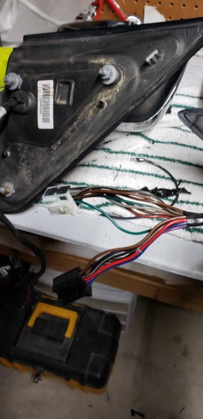

Anyone know while we are on the subject if these mirrors would through CEL or code on truck 2014 and above. The temp sensor possibly? I believe these were 2012 with power fold. 4b189ffc8ee25afce559f450972f4f50.jpg60e5f8e78ed1dec2c18dd1d67e675888.jpgcf641c21e6159a3613d0ee898c42ccf0.jpg

@KiltedCelt01 Not sure what all if any difference there are between the two, but your door module looks like mine. You just need to install mirrors and plug in the additional white plug to the module. Hopefully the other dealer will be a little more interested in your business.
@Jkieffer They are definitely power fold from the image you supplied. However, I can't answer your other questions.
