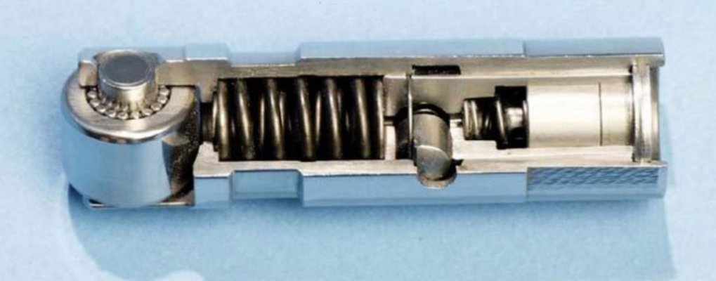

The main concern I think is MDS lifters and the oil passages inside.
If regular maintenance schedules are followed using recommended fluid's at the prescribed interval changes including sever use recommendations. The engine shouldn’t see any significant wear or malfunctions.
