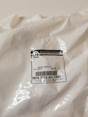

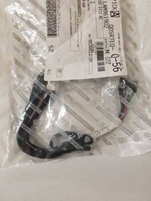

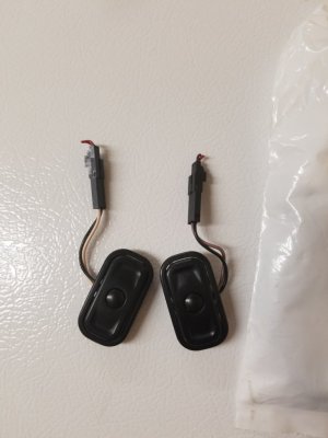

What does it take to add the 2 buttons on the back of wheel to control the volume and change stations/songs? I bought the buttons and have the harness, anything else needed? Its the 5.0 radio in a 2014 1500 express.

You'll need the new back cover that has the cutouts for the switches.
I should have looked earlier, i took for granted i felt spots to cut out. Just went out and actually looked.....lol.

They sell kits with the new cover, the switches, and the wiring harness. You have to pull the steering wheel of course, but before that you have to remove the airbag. There are a few write-ups on this forum with all of the info you will need!

Thanks guys. I have the buttons and harness, just need to buy the correct steering wheel back piece then. Thanks again!

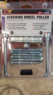

And although it was covered in the thread linked above, here is a picture of the steering wheel puller mentioned. It was in stock at my local O'Reillys.
If you get anther brand, just make sure it has the 2 "L" shaped puller legs shown here.
