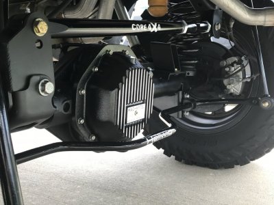

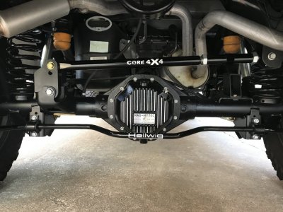

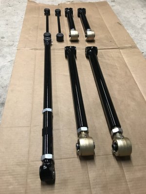

I have the Core4x4 Panhard and I can tell you it’s heavy duty. I have the control arms and sway bar end links from Core4x4 as well. Just email Spence Schramm and tell him your trucks specs what you want. He can/has also made them with a bend in them for diff cover clearance.
