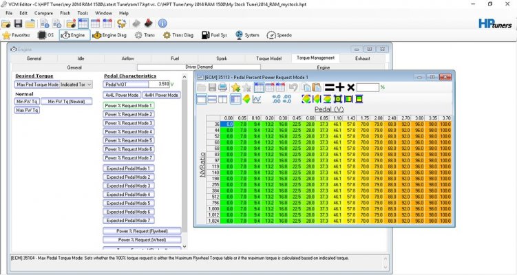

Couldn't be any easier in this truck, one table as opposed to 3 in the Challenger Scatpacks :)
The table is found in Engine/Tq Management/Driver demand/Pedal Characteristic/Power % Request mode 1
This is the stock table
30990986457_8dcc77595b_b.jpgstock_powerrequest by Wrangler RSM, on Flickr

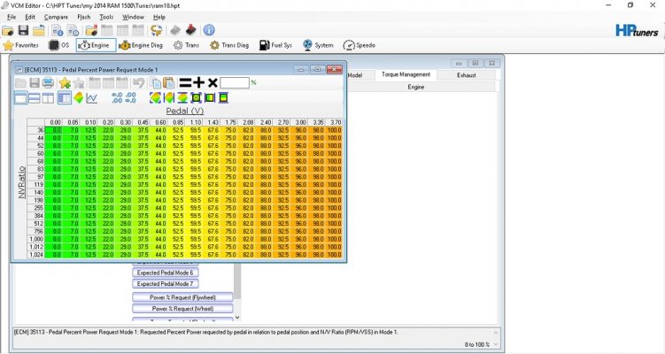

And slighly modded to make it a little more sportier, factory throttle is fairly lazy in the this trucks, this way the pedal is a little more crispier from a dead start.
30990986587_ec191ba634_b.jpgmoded_power1 by Wrangler RSM, on Flickr

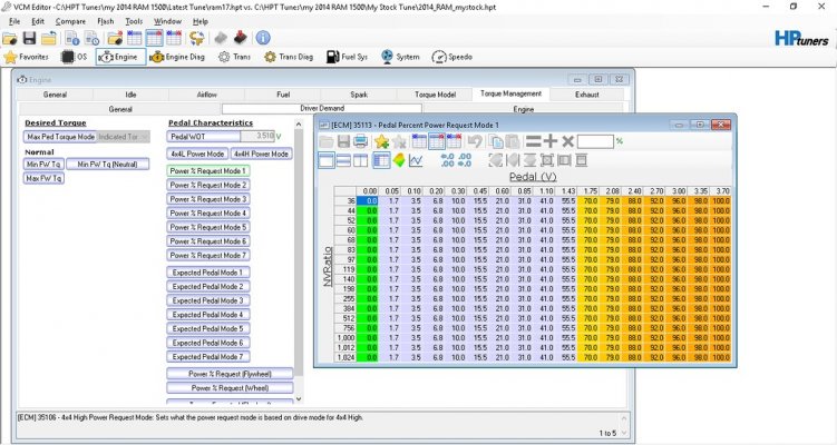

I made it more aggressive, but didn't like the neck snapping feeling with min pedal intervention at every stop light, this is pretty much the same pedal response the truck runs when when the transfer case is in 4lo, which seems to use the Power % Request mode 6 table, I’m running the truck with the table above, this one below was part of the test.
30990986557_eb0789583e_b.jpgmoded_power2 by Wrangler RSM, on Flickr
