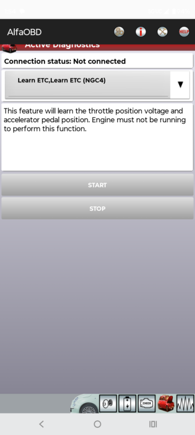

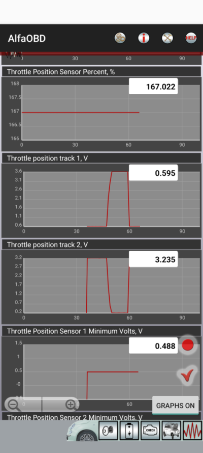

That does seem like a calibration issue.
I attached a graph of the throttle signals when opening the throttle plate by hand. They seem correct based on what I've read, though it looks like the calculated throttle position % is stuck at 167% (probably just not calibrated).

Yep. I've tried it a few times. I'm not 100% sure whether it wants me to turn the ignition off and on, or start and stop the engine when it get to "Cycle ignition" at the end, but I've tried both.

Thanks for the offer and the help! I think the throttle body is good (fingers crossed!) and it's all working now. I disconnected the battery and grounded the 12V bus to discharge everything. THAT solved the throttle body related codes and the truck would idle well but not accept accelerator pedal input. I then had to run the "Learn ETC,Learn ETC (NGC4)" to get the pedal re-calibrated. That got back throttle control, then I just had to reset a related transmission code to clear the check engine light.
As a bonus, I think I'm getting stronger startups and smoother idling now. The old throttle had some carbon buildup and something was obviously going bad on the sensor board. That might explain why it would occasionally die at startup.
