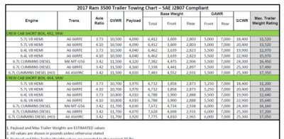

The 2500 is actually rated to tow slightly more than a comparable 3500.
I also don't go by the payload ratings from the factory especially since their is no legal reason to, but that is some people preference. While I will not say that my 2500 will not be able to handle the 4k payload that a 3500 like my truck will, I will say that it can safely and reliably handle way more than its 2k payload. I put about 3k in the back all the time and it safely handles it without much squat.
It just all boils down to whether you are one of those that wants to go by the payload sticker and don't mind paying the higher registration fees(depending on where you live) for it. As stated, there is no legal reason to abide by the tire load and inflation sticker and it depends on ones experience and knowledge of these trucks to make that decision. After all, some people need a "Do not touch while engine is running" sticker next to the serpentine belt while others don't.
Also, if someone gets tires that have a lower max capacity rating than the stock tires(which happens all the time) then the number on the door is useless.

Well, then go ahead and post up the sale trim level truck in diesel but one 2500 and the other 3500. Show me that the 2500 tows slightly more.
On your other points, I don't disagree. However, just because you can doesn't mean you should.
SouthTexan
Jan 24, 2015
2,149
1,305
408 CTD
Ram Body Builder's Guide (<---open in ie, will not work in Chrome)
As you can see, the 2500 diesel is rated to tow the same or a little more than a SRW 3500 diesel in a comparable configuration.
As you can also see, the max GVWR of the 2500 trucks is 10k due to its 2b class regulation. I can guarantee that if DOT changed the 2b truck class to have a max GVWR of 11k, then the Ram 2500's would have their GVWR's increased to 11k overnight without them changing a thing.
I have worked in the medium and heavy duty truck industry all my life and have had to deal with these outdated truck class weight regulations that were made decades ago. The max weight limits of most of the classes are outdated because trucks have progressed in capabilities and the limits have not changed to match them. This would require a bureaucrat to do his job so I would not hold my breath waiting for it.
Until then, I will rely on my experience and knowledge of trucks to help me make a sound judgement on what loads are safe for my class de-rated truck. I generally keep my loads below 3.2k and tow no more than 14k. My 2500 has shown that it will easily and safely handle these weights, and I do not need to tow or haul more than this so I feel no need to get more truck than this.
Judging by the recent threads and posts of 2500 owners safely hauling more than the what their truck is rated for, I do not feel I am alone in this sentiment. If some feel they need to be within rated numbers to be safe, then by all means get the 3500. I am just not one of those people.
