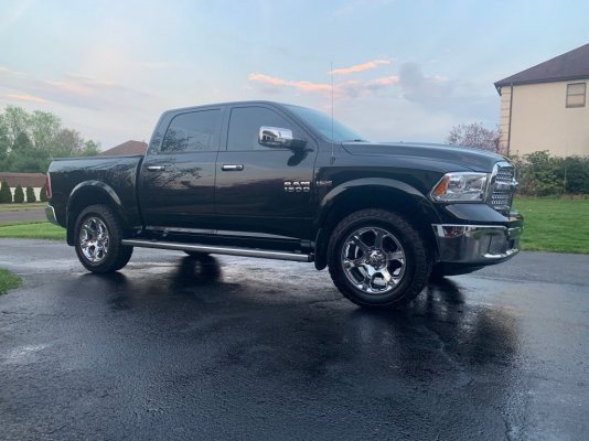

I ripped out my air suspension last year with a Bilstein kit from airdelete. I went with the fronts set at 2.1" and I went with a +1" rear spring with added tow capacity. Although I didn't measure, it appears to me to now sit pretty similar to the offroad 1 setting. It wasn't too bad to install and probably took 4 hours or so with me going pretty slowly. I also rented the tool for getting rid of the error codes. I'm pretty happy with the ride, but I'll admit it doesn't ride as nice as the air suspension did. Its definitely rides more like a truck now.

Your truck looks exactly like mine, minus the ram boxes. Great looking ride!
Thanks for the info. I think it's time to transition to a luxury sedan for a daily driver. Give the truck some rest reps. I can live with a truck like ride if it's only used for towing and hauling! I looked at trading it in. But I just replaced the cam and lifters this year and hoping to get 275K miles out of it. It still looks great!
