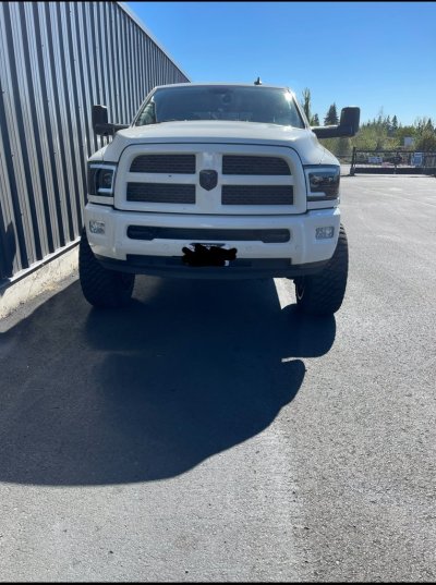

That's good to hear they are working correctly. I have seen a pair of these headlights on Marketplace and I really like the look of them. Do you have any photos of your truck with them installed?
First picture is with auto start lights on , second and third are normal lights on
