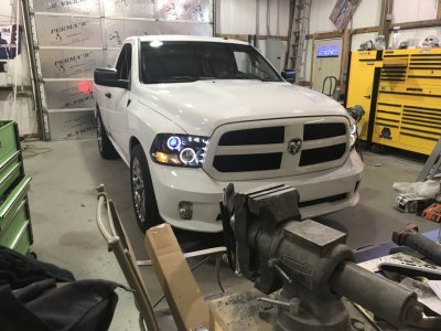

Ive been running these Vipmoto led projectors for awhile now no moisture. only complaint is the adjustment requires going through fender linerIMG_2637.JPG

Did you have the quad lights or projectors originally. I have the projectors and most lights like you have now, which I like, say are not compatible which are advertised as projector style. I'm just wondering if it has something to do with the original wiring harness.
You are right. The main drawback of having the OEM projectors is the wiring harness. It is different than the non-projector housings and will not work with the majority of aftermarket housings unfortunately. I know there is an adapter out there that allows you to go from non-projector to projector housings, but idk about the other way around.
If I was you, I would first try to dry them out again (I had to put my drivers side on my floor vent in my house for the day) and then make sure you adjust the vents on the back of the housings (the 3 little caps come pushed all the way in from the factory and need to be pulled out to allow for better air flow). Mine had moisture, did this, and there has been nothing sense; and MANY others are in the same boat. If you are dead set on getting new housings, the OEM replacements (around $300 on ebay) are pretty good and have a better projector than the factory if you like the stock look. If you want more/better light, I would recommend doing a projector retrofit. I can't comment on what options you have for replacements other than the OEM style due to the different wiring harness.
