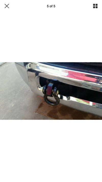

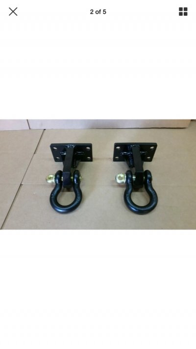

Noticed this morning that my new to me 14 2500 doesn't have front tow hooks. Looking for aftermarket options. Don't want factory hooks since A) they are ridiculously expensive and B) I hated the tow hooks on my 06 and it doesn't look like the design has changed at all. I've found these

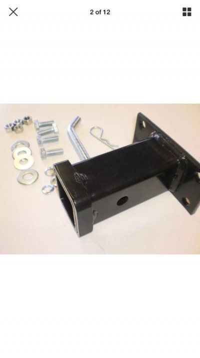

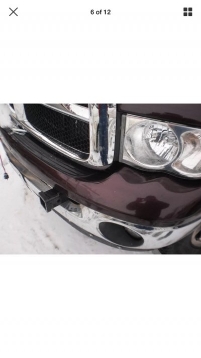

And a 2 inch receiver that mounts to the tow hook spot

I purchased the first set, they are built well but coating on them was crap on the set I received and ended up coating them again after getting no help from seller.
Just FYI

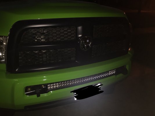

Isn't there something about how our tow hooks are mounted that if u actually use them it bends the bumper? Mine didn't have tow hooks either. I just mounted led pod lights in the space.
Just FYI
sorry to get off topic, what size lightbar is that?

I realize this is old but you can get a front reciever hitch for 10.00 more and then at least you are pulling from the middle utilizing both mounts
Kicking that idea around as well. Also considering an aftermarket steel plate bumper with D-rings.
