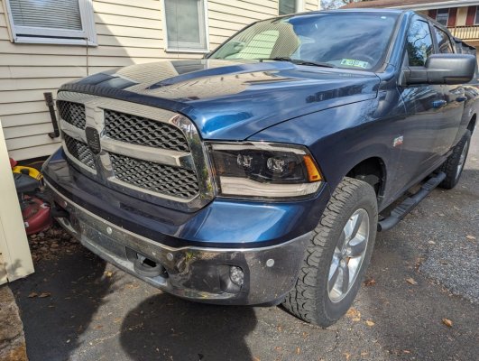

I have aftermarket headlights that require the headlights to be removed to aim them. Big pain in the butt but I like the look. Anyone know of any aftermarket lights that have the factory style adjustment?IMG_5236.jpeg

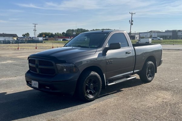

I posted that Form lighting will soon be offering full LED housings for the 4th gen that will be plug and play for the quad trucks. They look similar to the alpharex options, but are far superior in output to the alpharex housings thanks to a superior projector design. Alpharex projectors have no real hotspot, which kills downrange visibility. Tons of foreground, no distance. My thread has a link to the Instagram video that shows high and low beam.
These lights are no joke in terms of output. Offering lux readings that almost match aftermarket projectors from morimoto and NHK.
