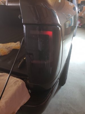

Has anyone replaced their factory led taillights with aftermarket led taillights? I bought a plug and play set and one is working, but gives me a bulb out message. The other one is barely lit. Maybe i just got a bad set?20180809_120543.jpg

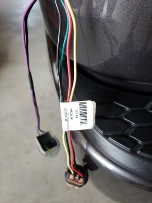

My truck is a 2016 Ram Sport crew 1500. These aftermarket taillights plug has 3 pins, where my factory taillight plug has 4 pins. Below is a pic of my factory plug wiring. Do i tap into these wires?

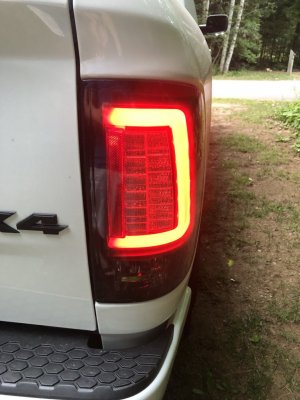

I use this style. They are can-bus compatable. When I get home will see what brand they are. The “C” bar is tail/running light. The res LED is stop/turn.
Sorry op, gonna go squirrel for a minute.
You got a link for those? I dig those right there. Is that a true fiber optic c? And does it look bright white when off?

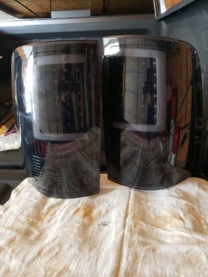

I just dont recall my plug looking like that but i could be wrong. Also the tube looks to be burnt out so maybe that is the cause of the bulb out error message. Do both aftermarket lights look the same when on?

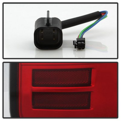

These tailights are direct plug in for factory equipped led trucks. One taillight lights everything up, but the other is just barely lit. They were both shown to be workkng in the pics that were shown on Ebay. The seller has already refunded my money and told me to keep the lights. Not sure what brand they are, below is a pic of the 3 pin plug on the aftermarket tails. Factory has 4 pins.

So with it missing one pin it may be a defect..good that you got your money back though
