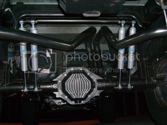

I'm pretty sure you might have to fabricate your own shock mounts, same as fabricating any shock hoops to put 2 on each side in the front.
I had mounts fabricated for my rear axle to use dual shocks on mine, looking at having mounts and hoops fabricated to mount dual shocks on front too.
This is the rear!
That looks sick! I want that. It'd be neat if somehow I could fab up shock mounts outside of my struts...
